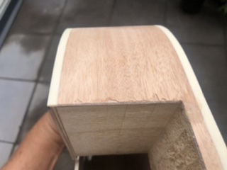

2 Attachment(s)
Thanks Simon. Here is photo of chips in ply near beach pocket. Any thoughts on how best to fill? I am using a colourless Dingotone finish from Pitbull. Not sure what type of finish this is, but have assumed it is oil based.
Attachment 35553
