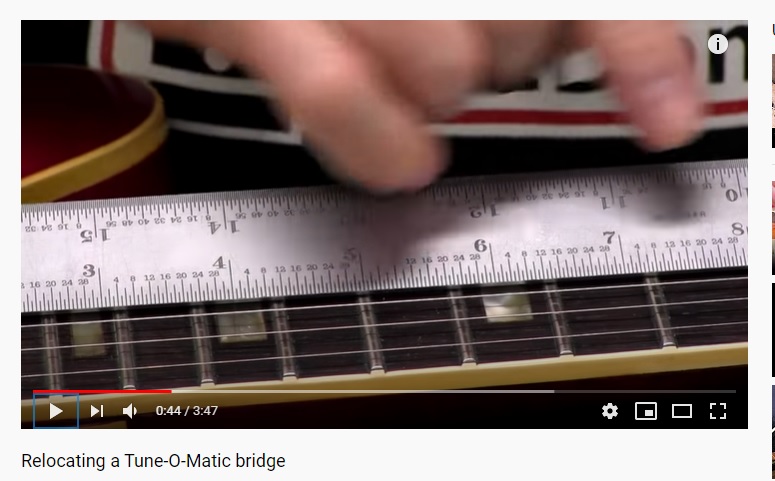

Hi guys,
Doing some checks on this AG kit and it seems the neck tongue needs moving away from the body about 5mm to get the right intonation. Thinking of glueing it in and adding a shim later. The neck needs to kick on a angle when glueing to line the strings up with the neck. Has anyone else had this problem?
