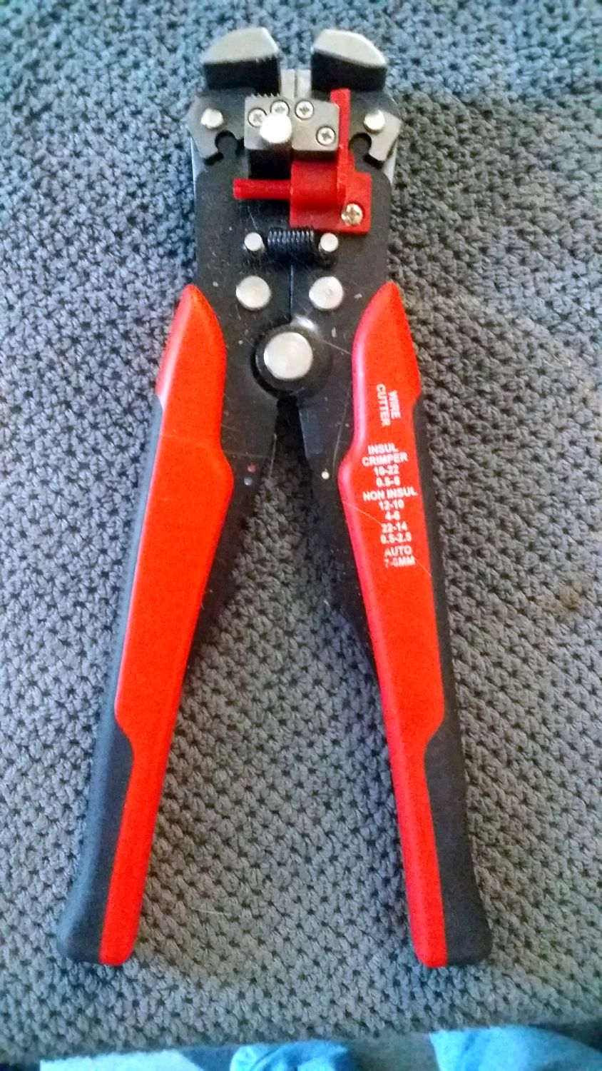

Look I'm no sparky but I thought I'd share this.
I don't like pushing back the cloth wire, especially when building amps.
So I strip the cloth insulation by twiddling the wire around in the B end of my $4 Jaycar RG6 cable stripper. Takes a couple of secs
You just need to be careful not to damage the wire, which you need to do anyway.
4 bucks...saves time...neat as. https://uploads.tapatalk-cdn.com/202...87e82b9b3c.jpghttps://uploads.tapatalk-cdn.com/202...ce67bc1939.jpghttps://uploads.tapatalk-cdn.com/202...3d9cc5e07a.jpg
