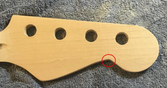

The nut must have come out in transit and the pick guard needs a little work to fit. Neck seems to fit ok.

Another question. I'm going to cut the headstock. I don't have a coping saw, but do have a jigsaw. The guide suggests using a jigsaw, is that a fairly standard way of doing it?
