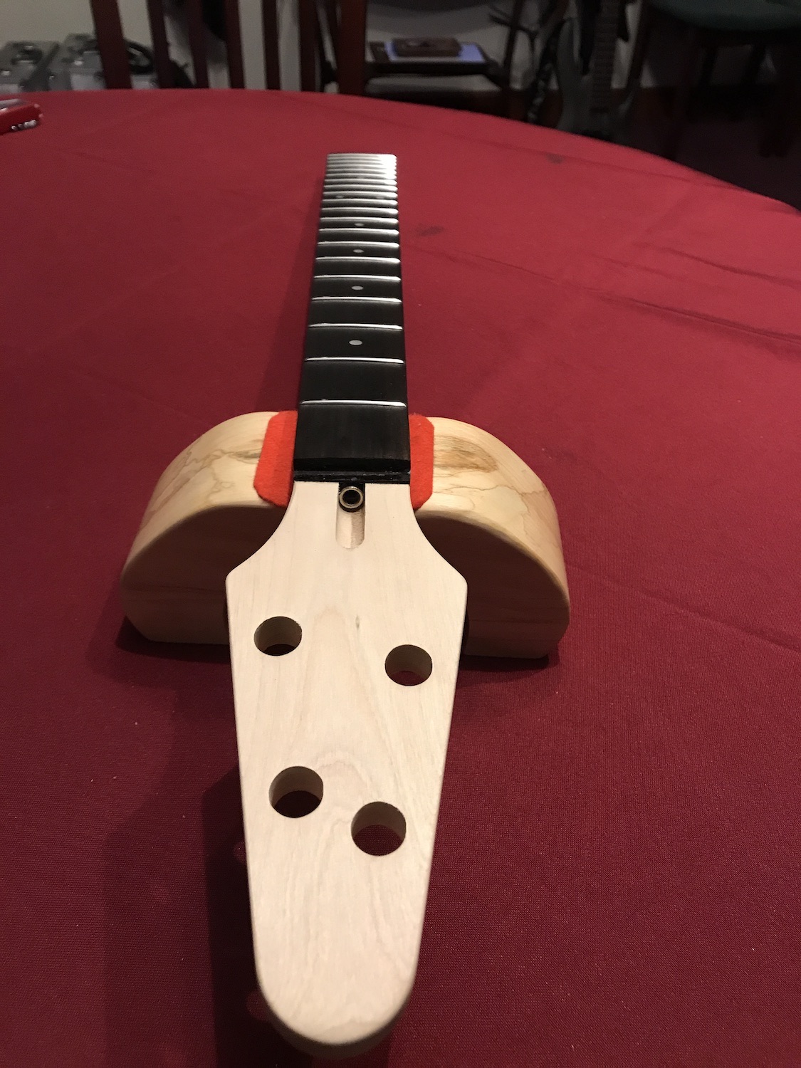

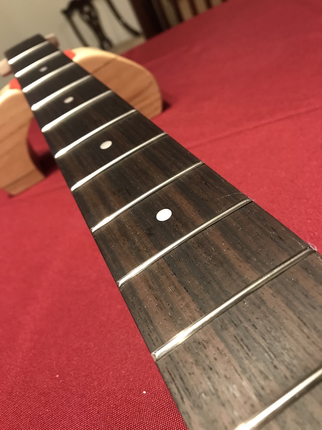

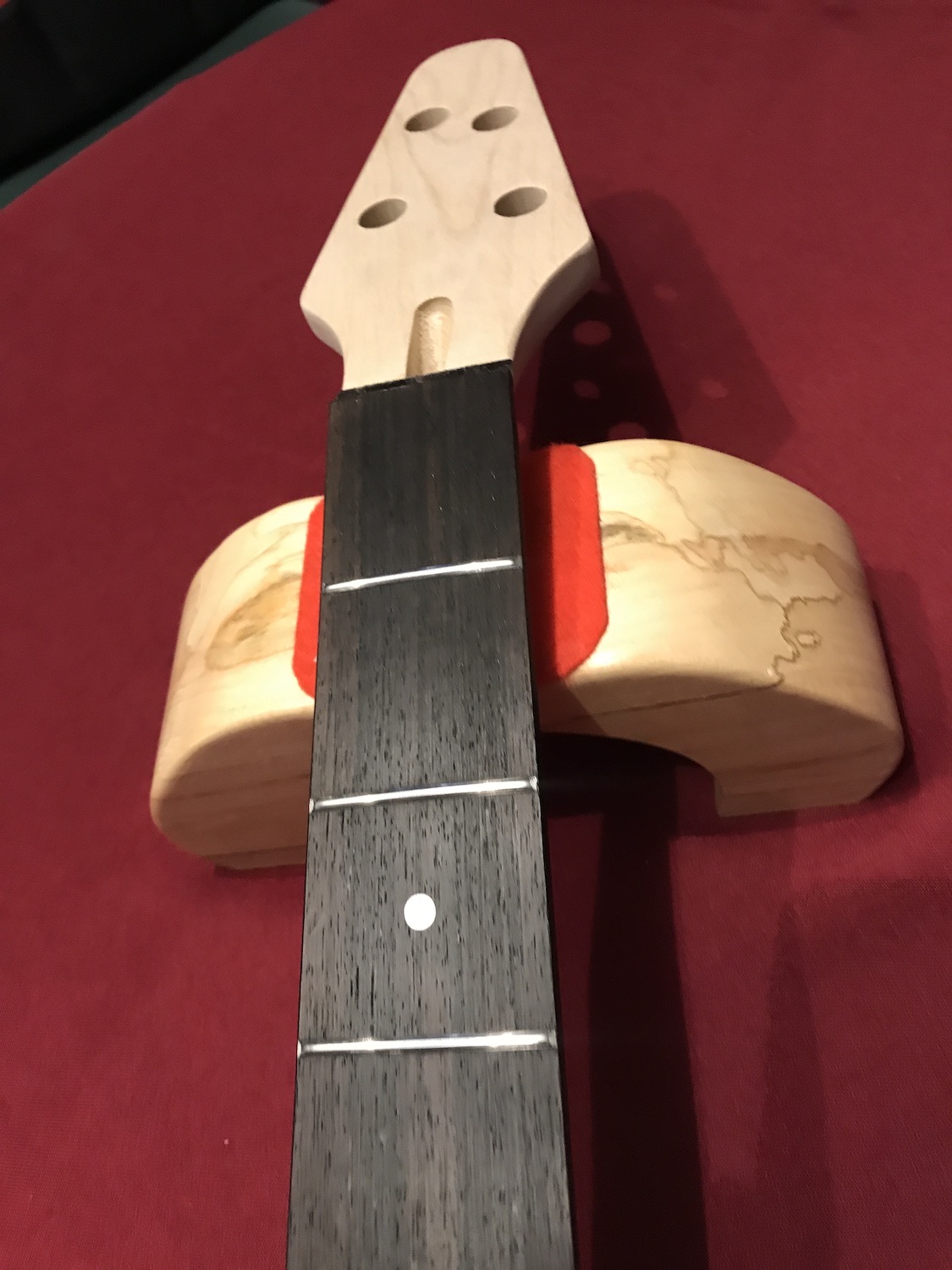

Started work on the neck today. It had a pretty big back bow so a bit of truss rod adjustment needed to get it flat. Then I levelled the frets, and crowned and polished them. Then cleaned everything up and finished with a little fretboard oil to make it all look nice. Very pleased with the results.
Attachment 33414Attachment 33415Attachment 33416
