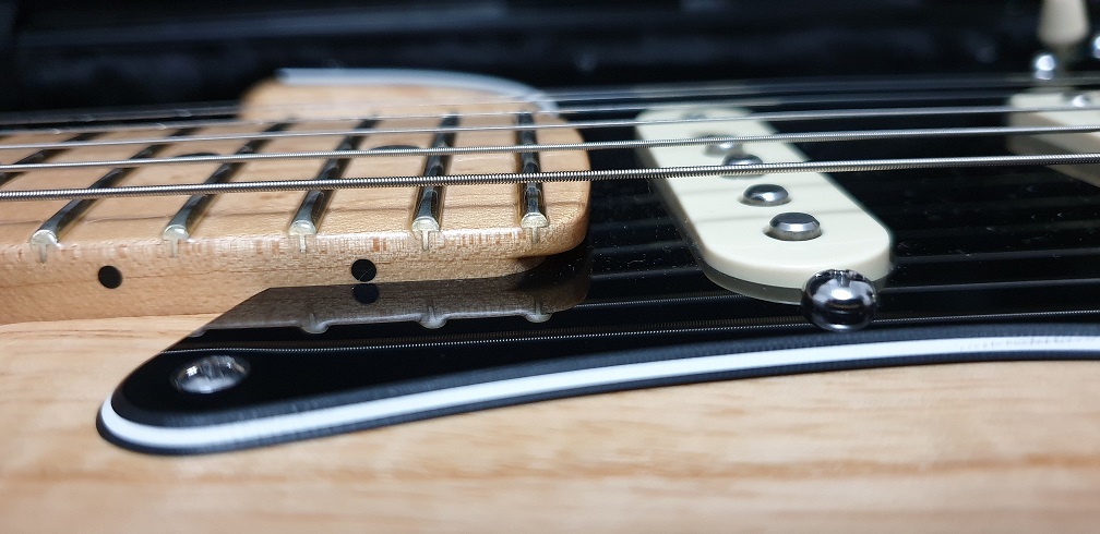

Is it normal for the neck to have some distance from the pickguard? Here's a picture of it.

Your question, "Is it normal for the neck to have some distance from the pickguard?"
Yes on a 22 fret neck it's normal.
Its more of just the neck clearing the pickguard and not flush with it

This is a genuine Fender 22 fret Strat. Hope that helps.
Attachment 33301
it does! Thanks for settling my worries
