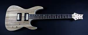

  7. #17
    hello all,
    i'm back !
    this model Click image for larger version.
ID:	27459is nomore avalaible ?
  8. #18
    3,191
    Quote Originally Posted by yom31 View Post
    hello all,
    i'm back !
    Private message Adam and see what is happening with them.
