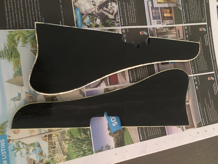

    Well, I tried to match up the colour of the white scratch plate purfling with the cream purfling of the guitar with some golden teak. It looked ok under artificial light, but in daylight the difference was obvious. I couldnít live with myself as it was so I ordered cream purfling and rebuilt the plate. The original plate was only stained with black rather than the golden teak/cedar/black of the guitar body, which showed up in the lighter section of the wood...not as big a deal as the purfling colour mismatch, but corrected that in the new plate. As you can see (or maybe not) the new plate is looking a better match. New plate is the top one.
