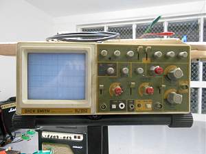

    Sometimes, when faultfinding a non-functional effects pedal, there'll be a need for being able to see what a signal looks like when tracing out the signal path in order to locate the fault that's causing the malfunction, of course, you can get away with just using an audio probe, or, you can use one of these handy pieces of test equipment:
Name:	20 Mhz Scope_resized.jpg
    This handy piece of test equipment is a device called an Oscilloscope.
    Why is it handy?, because it displays on it's screen what the signal looks like, and, from looking at the display you can learn a lot about how a circuit is actually behaving, it is also very handy to have because some types of effects pedals need to have adjustments done on them in order for them to operate properly, as a demonstration, I will be posting some screenshots of the Oscilloscope you see in the pic I posted, I will be using it to look at the output signal of some of the effects pedals I have in my collection, some factory made ones, and some that I made myself, I thought that it would be interesting to to post the screenshots so you can see what the pedals actually do to a signal coming from an electric guitar.
