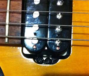

    Judging string height on an unfinished build is the challenge as I had to re-do mine on the EX-1 a couple of times as originally (as in that photo) they were set too low and deep into the body and when amped up were lacking the serious grunt they were supposed to have. Raising them about 5mm made the world of difference.

    Just took these shots 10 mins ago to show what it looks like now. Hope this helps in some way?

    Yeah that's brilliant Waz, thanks for that mate!
