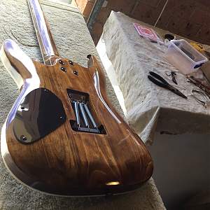

    I agree with you on the Floyd, I just couldn’t tune mine without the bridge lifting right out, but I didn’t add extra springs, I stretched the outside two into the centre pins and screwed the claw almost right up to the body.Click image for larger version.
    Looking great though.

  7. #206
    Overlord of Music FrankenWashie's Avatar
    3,527
    Yeah I went there initially wth the three springs Wayne, but it just felt wrong and the instability it caused was unworkable.
    it sits angled slightly back now so I figure when I change up to the heavier gauge set it will pull it up a bit harder.
    The nut is a pain and even a moderate tension on the locking screws caused a strip. Will pull it apart and see what can be done with it, I’ll persist with it until it pees me off enough to change it out completely.
