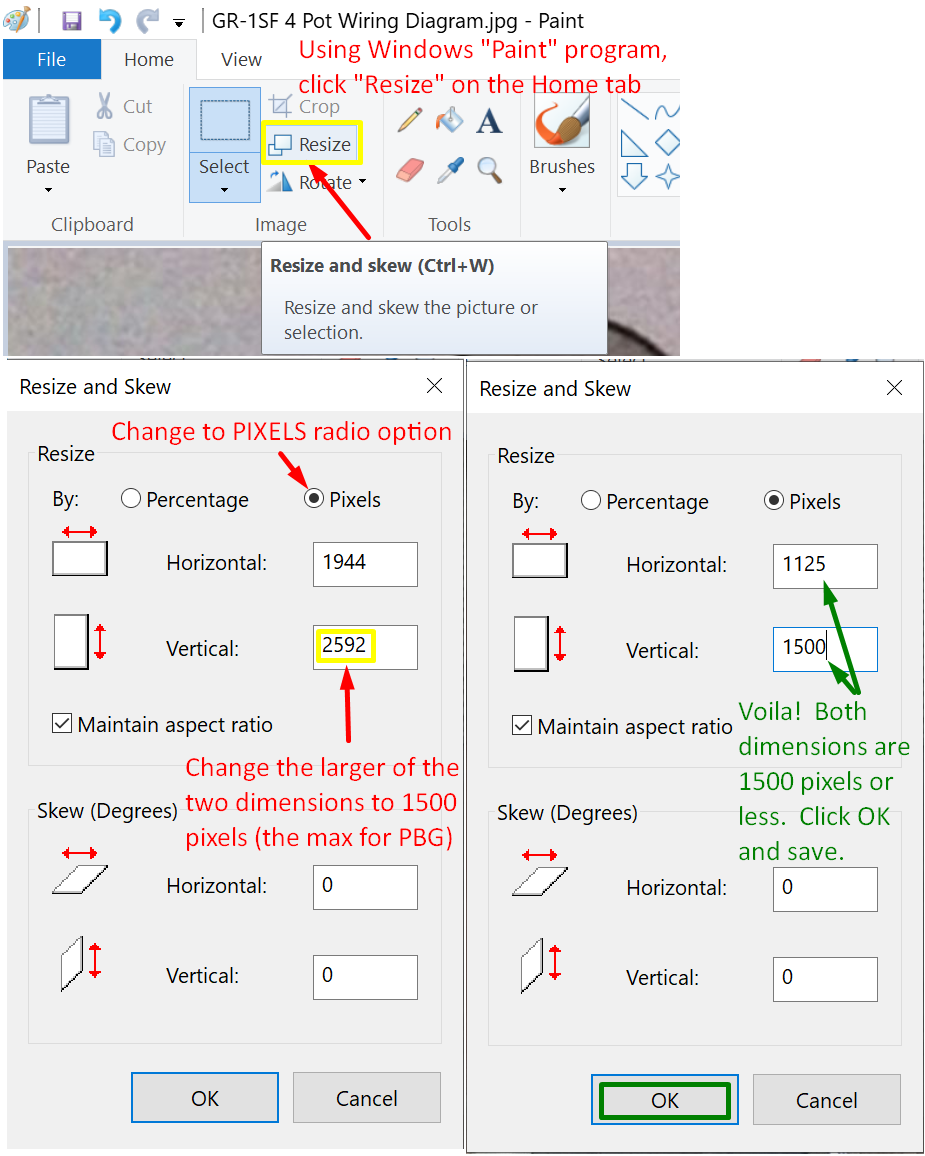

    Quote Originally Posted by Jeff Sheridan View Post
    Now if I could manage to figure out how to resize pictures I will post soon!
    Here's the simple way to resize images if using Windows Paint:
Name:	How to resize images in Windows Paint.png
    Best regards
    Grant
