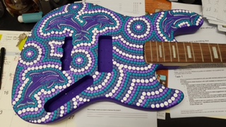

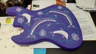

    Ok here we go..... these kids have done an amazing job! I'll get it back and get some better pics during the school holidays and start to put it together. I think I'll need to sort a mini front pickup mount, really don't want to cover this paint job...

    That's brilliant!
    Could you get Pablo to make you a clear scratchplate and just spray the back around the front pickup area (rather like a paisley Tele)?

    Might need ferrules for neck mounting screws and ditch the plate to save that part of the design on the back.
    Looks great.
    Is there much of a raised texture where the dots have been painted?

    Excellent idea with the ferrules too! I have found a clear jazz scratchplate and ordered it. Figure I can leave the pickup cavity unshielded to show the purple under the pickup? I'll shield all the electrics under the pots of course.

    The dots will be raised I'd imagine, I'll clear it and leave the texture. It has been done inacrylic so an acrylic clear.
