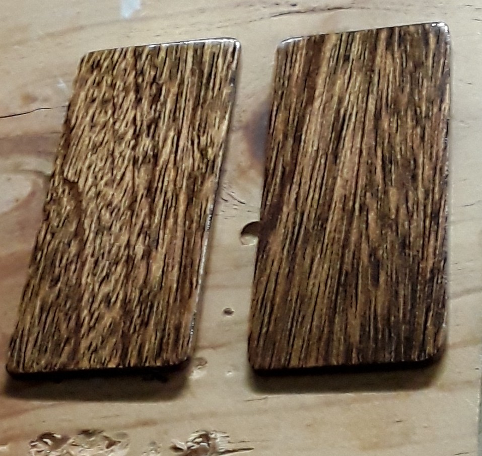

    Attachment 26501 looks loke I'm making new pickup rings too
    Oy. Bugger. Well at least you have your method down eh?
  2. #112
    Mentor Adam Barnes's Avatar
    Feb 2017
    norah head nsw
    613
    Yep franky, first cut the shape out then fibre glass tape, ebony timbermate and sand back, bushfire sunrise and sand back, black stump and sand back, finally clear coat, cut the pickup rout out and drill the holes and hope i dont snap them along the grain. Its gonna be fun

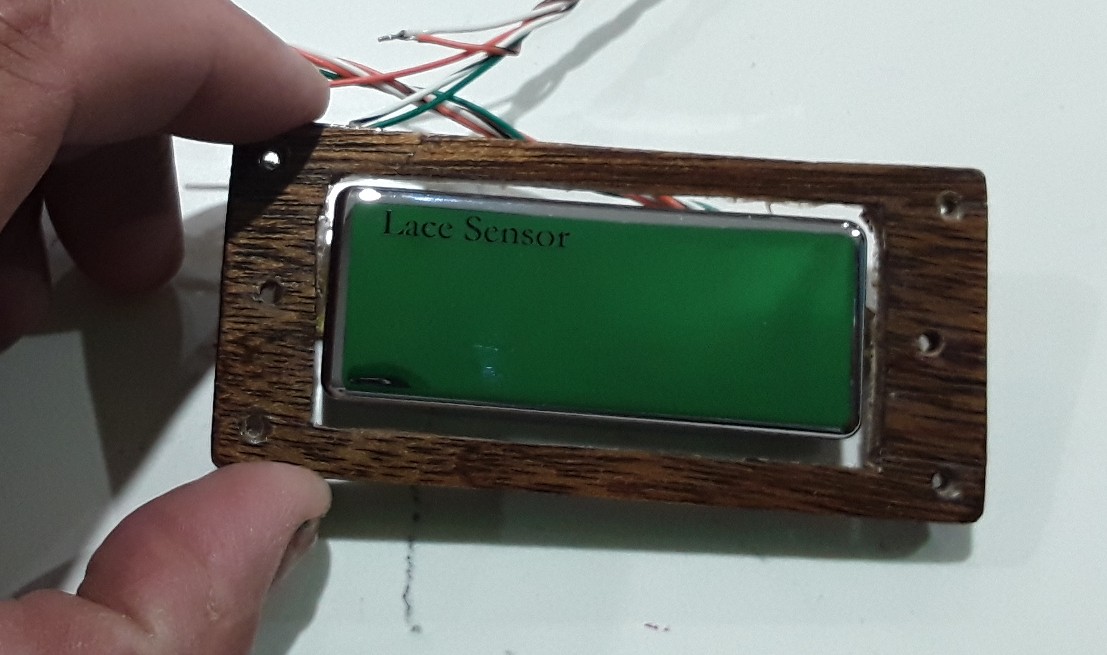

    No idea waz there called nitro hemi mini aparently there a direct replacement for an gibson firebird pickup which must be smaller than the kit mini buckers.
    I think there a mini humbucker
  5. #115
    Yep, mini humbuckers. They look impressive and hope they as good as they look.

ID:	26605 new pickup rings are coming along nice using the tounge oil i had left over from a job, as i have 10 litres of it its lookinggood for the next guitar

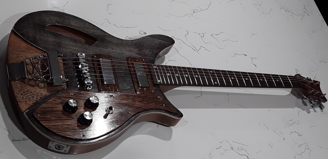

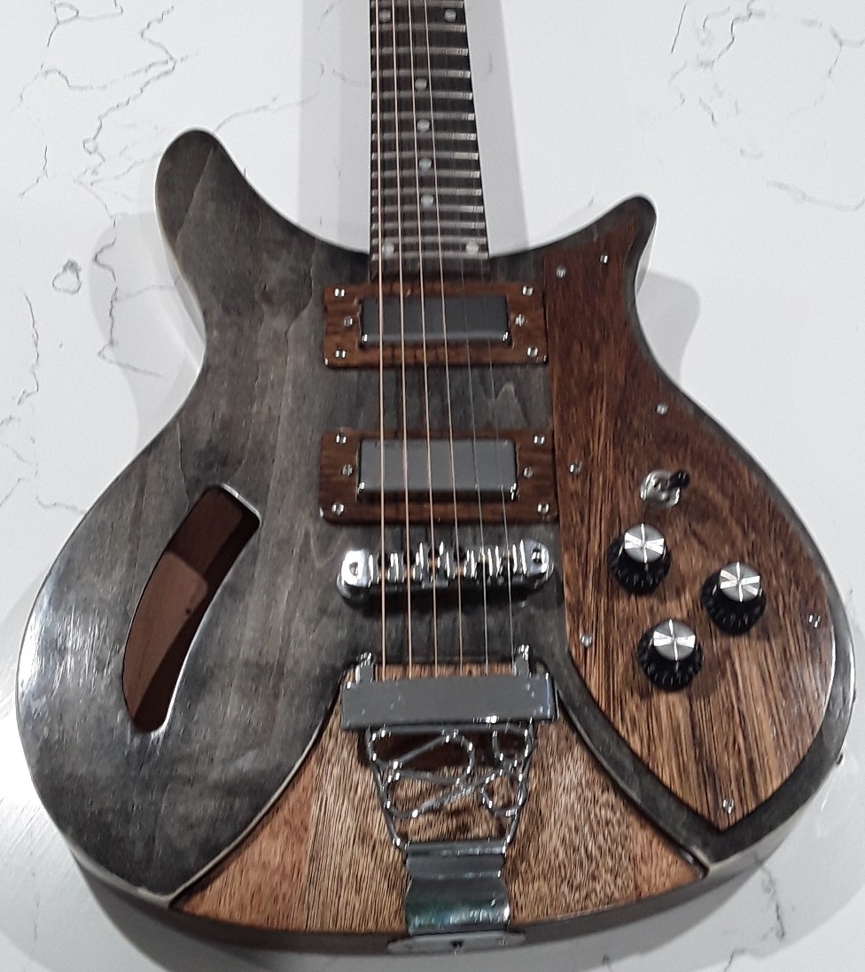

    All back together today, strings need to settle for a week or so, the new lace nitro hemi pickups have got some great bite. Only had a quick 5 min play to see if it all worked, cant wait to give it a good test out later in the week
  8. #118
    Mentor DarkMark's Avatar
    Sep 2017
    1,574
    I like it a lot Mr Barnes.
