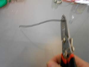

    Cut:
    I used my wire stripping-tool to cut the piece of wire to the required length.
